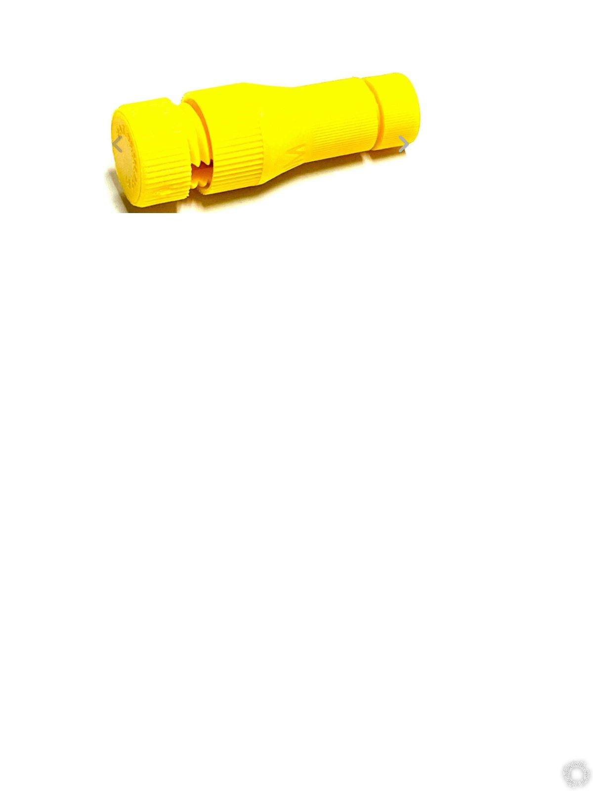

What would be a good alternative besides cutting/splicing/soldering?
Upon further research looks like I should have gotten some Posi-Taps. Those look great and secure.

I do occasionally use Posi-Tap connectors to make a temporary connection on CAN wires during bypass module programming. These CAN wires are typically 20 or 22 gauge. I have heard that the Posi-Taps work well for permanent connections. They aren't cheap and they are gauge range specific.

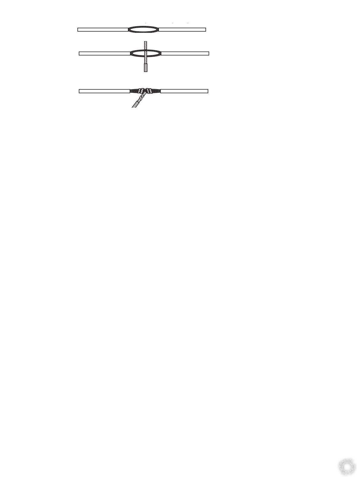

There is another way to make a decent connection in a favorable environment. It's called the "Poke and Twist" method. Description below.
This would be for your thick gauge vehicle ignition wires (but will work with thinner gauge wires). Strip about 3/4" inch insulation from the vehicles ignition wire in an accessible area. Strip about 1 1/4" insulation from the end of the R/S ignition wire and put a tight twist to the exposed strands of wire. Using a pointed plastic tool, separate the vehicles ignition wire braids into two equal parts creating a gap you can poke the R/S ignition wire through. Then tightly squeeze the separated wire back together and then wrap the R/S wire tightly around the exposed vehicle wire, both sides. Align the R/S wire with the vehicle wire and apply Scotch Super 33+ insulation tape. Use tie wraps to secure the R/S wire to the vehicle wire over the insulation tape and the other end of the insulated area. Some diagrams from Bulldog Security below :
