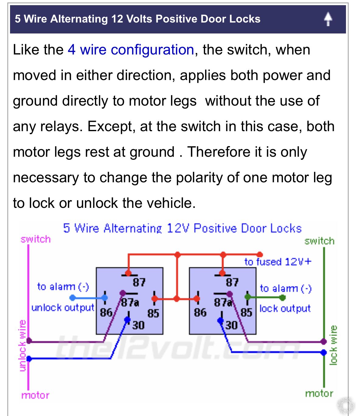

1997 Dodge Ram with power door locks but no factory keyless entry.
Installing Viper 4103xv
Where on the door switch do I connect the 87a wire?
Where On Door Lock Switch Does The 87a Switch Wire Connect? - Last Post -- posted image.
Where on the door switch does the 87a connect?
Thanks!

Posted: November 05, 2022 at 3:33 PM / IP Logged Link to Post Post Reply Quote i am an idiot
https://www.the12volt.com/installbay/alarmdetail/730.html
