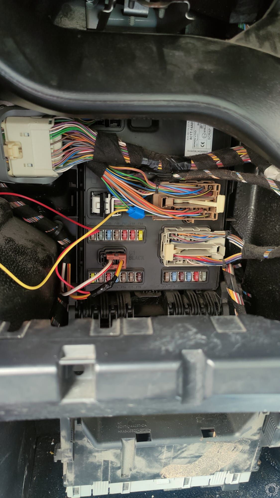

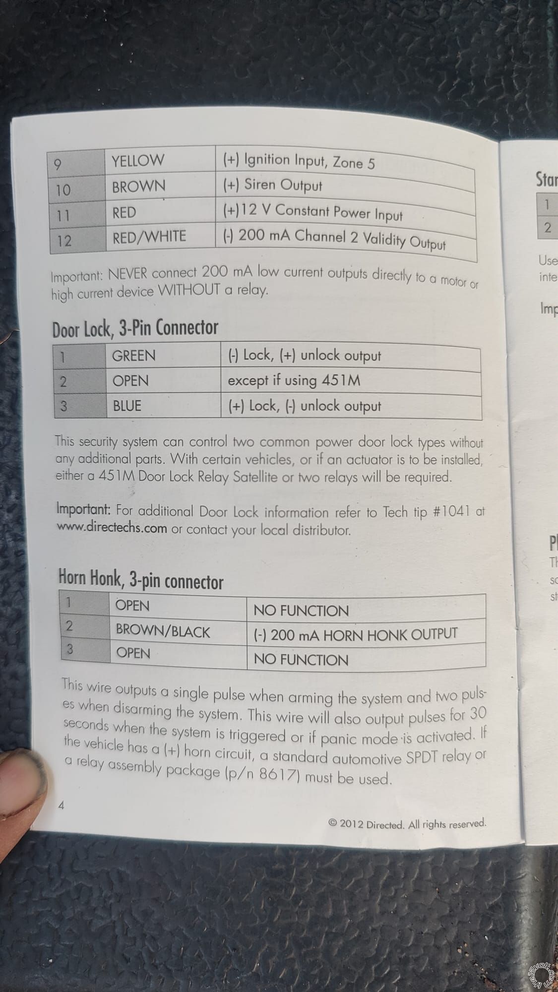

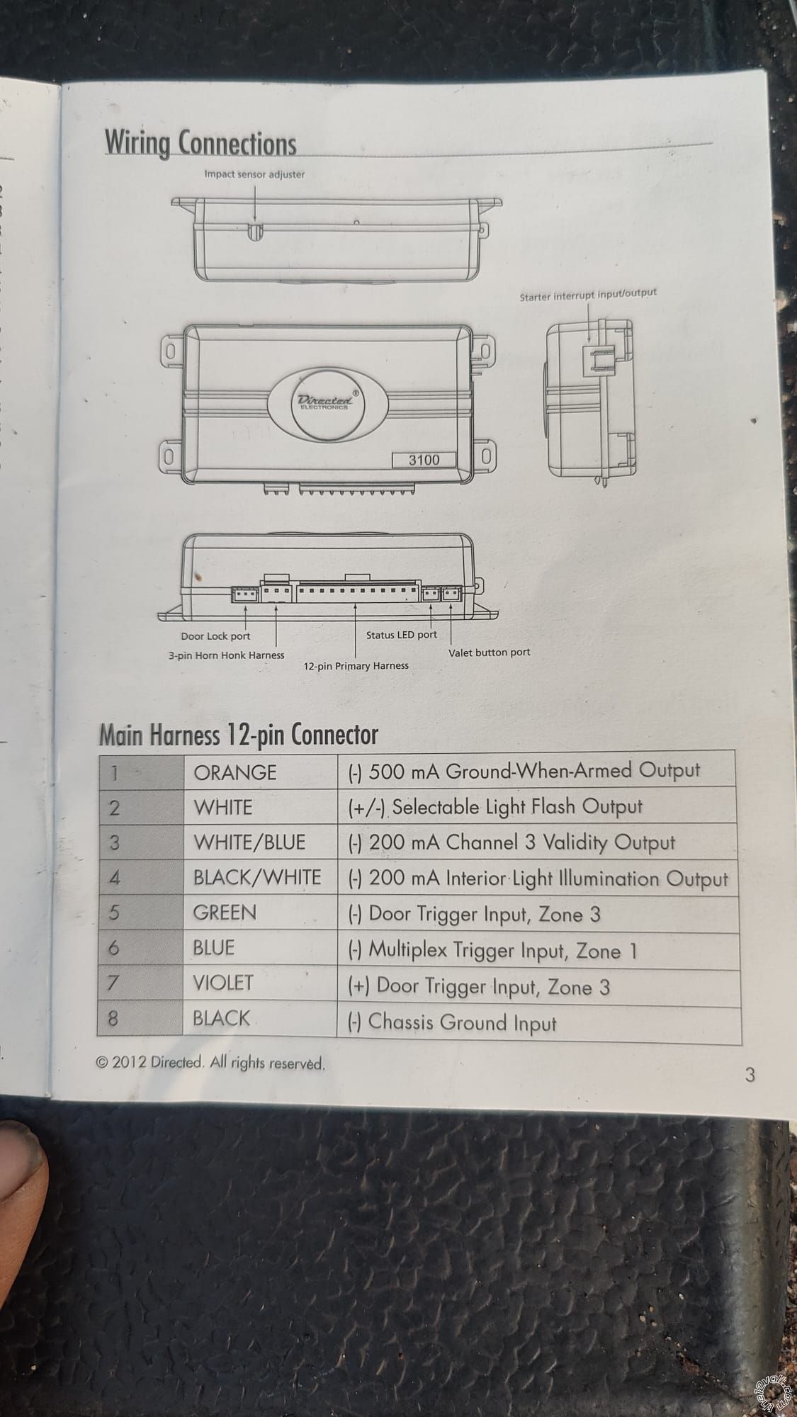

Can anyone please offer any advise on installing an Avital 3100 on a Mk7 Ford Transit here in the UK ?
I have connected in the red (constant +12v), Black (Ground) and Yellow (accessory) wires. I need to connect the door pins, lock, unlock wires etc. Can anyone point me in the right direction to find the correct corresponding wires on the Transit ?
Thank You !
