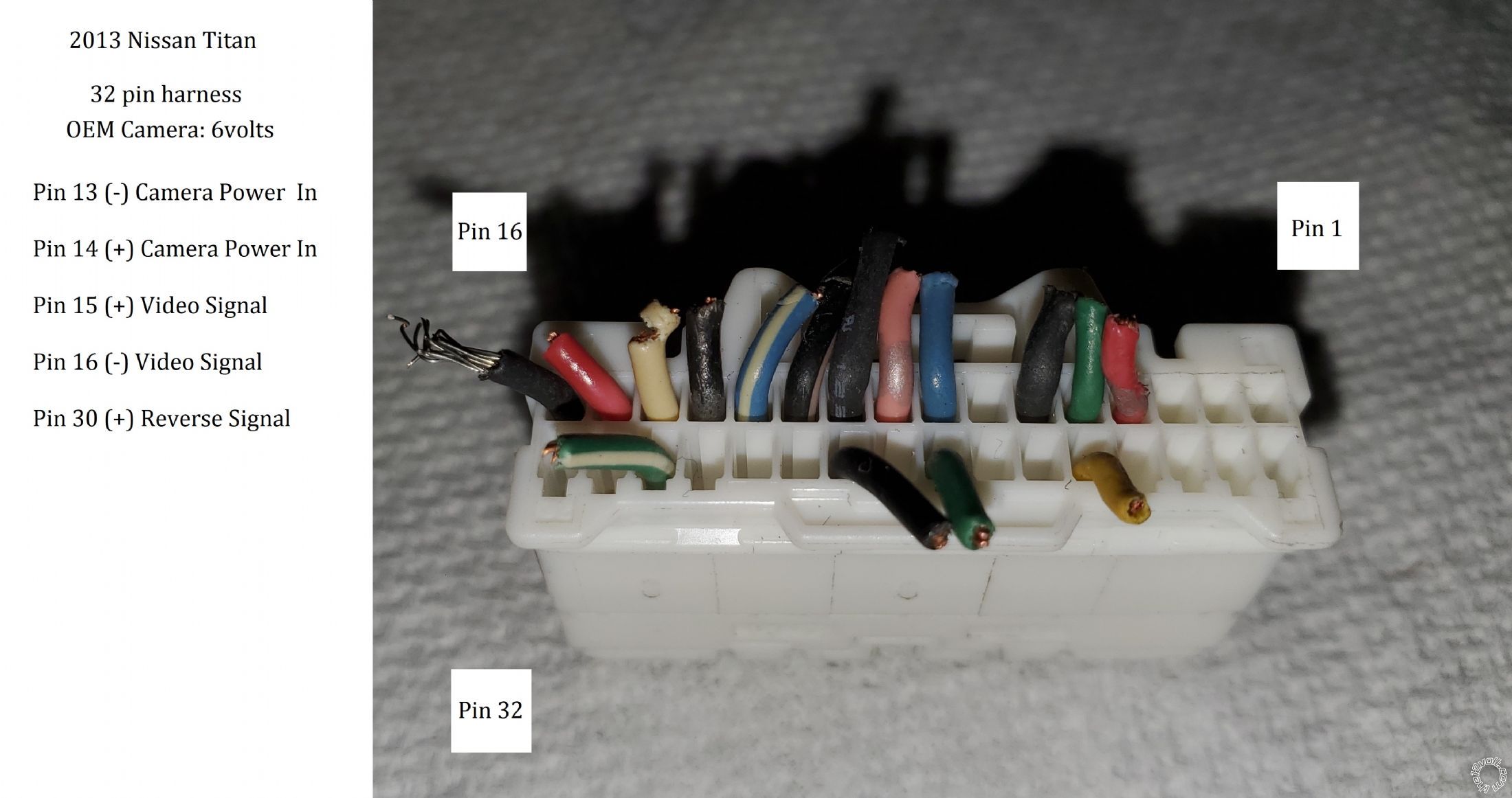

2013 Nissan Titan, Rear Camera Info
jt3nevermore
Joined: January 19, 2012
Posted: October 25, 2023 at 3:45 PM / IP Logged Link to Post Post Reply Quote jt3nevermore
2013 Nissan Titan, Rear Camera Info - Last Post -- posted image.

Posted: October 30, 2023 at 8:37 AM / IP Logged Link to Post Post Reply Quote jt3nevermore
Thanks for the Harness links, which is the preferred method of interfacing, this customer did not follow that line of thinking, so I had to repair it and could not locate any wiring information for this harness, which is why I posted it. I tried to submit it to DEI, but their service was acting up.
