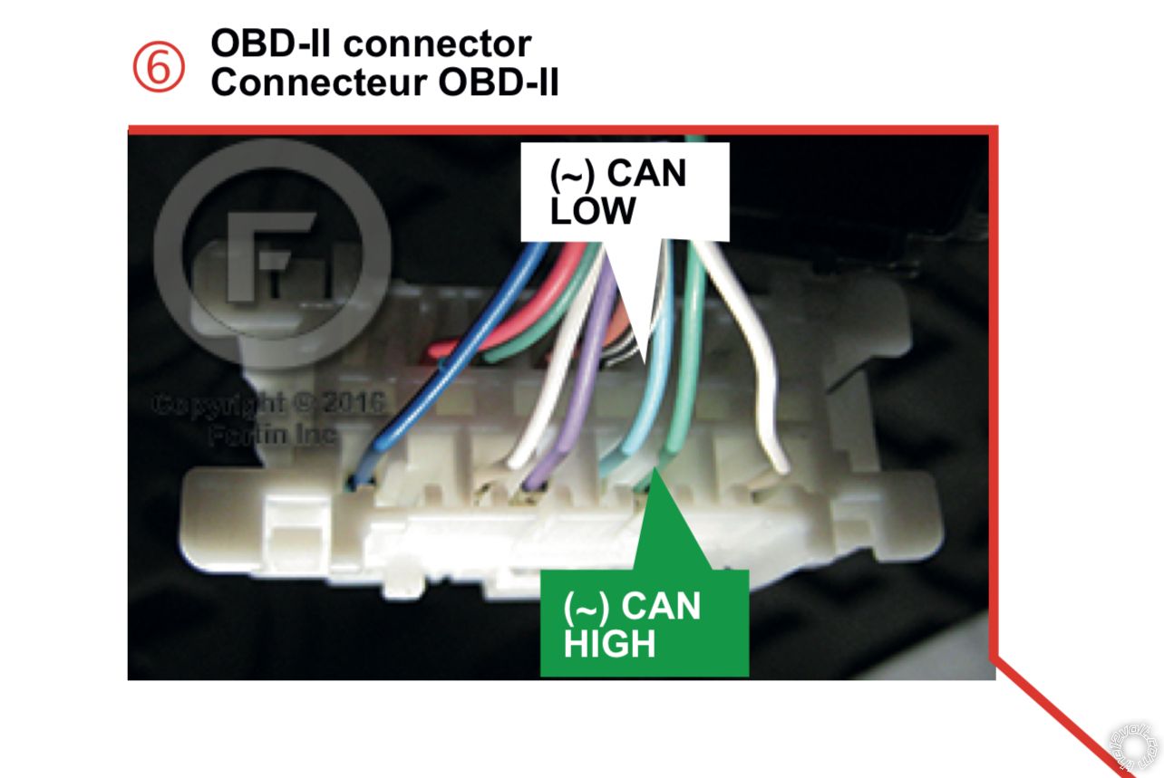

I looked for the Can Low and Can High wires but im having trouble. In the picture I posted which is from Fortin, the Can Low is actually an empty slot. Could the wires actually be over the on left side next to the blue and purple wires? 2009 Lexus IS250, Fortin Evo One Install - Last Post -- posted image.

Take a close look at the OBD2 connector to see if it has the Pin numbers marked, some do, at least Pin 1 and 9. It depends on wether it's a front or rear view, too. You are probably correct that the wires you want are on the other side of the connector. Additionally if you strip back the insulation far enough you will see that those CAN wires are paired and twisted together.
Info from another source is the same :
CANBUS HIGH & LOW    GREEN (HIGH) WHITE (LOW)    @OBDII PINS 6 & 14

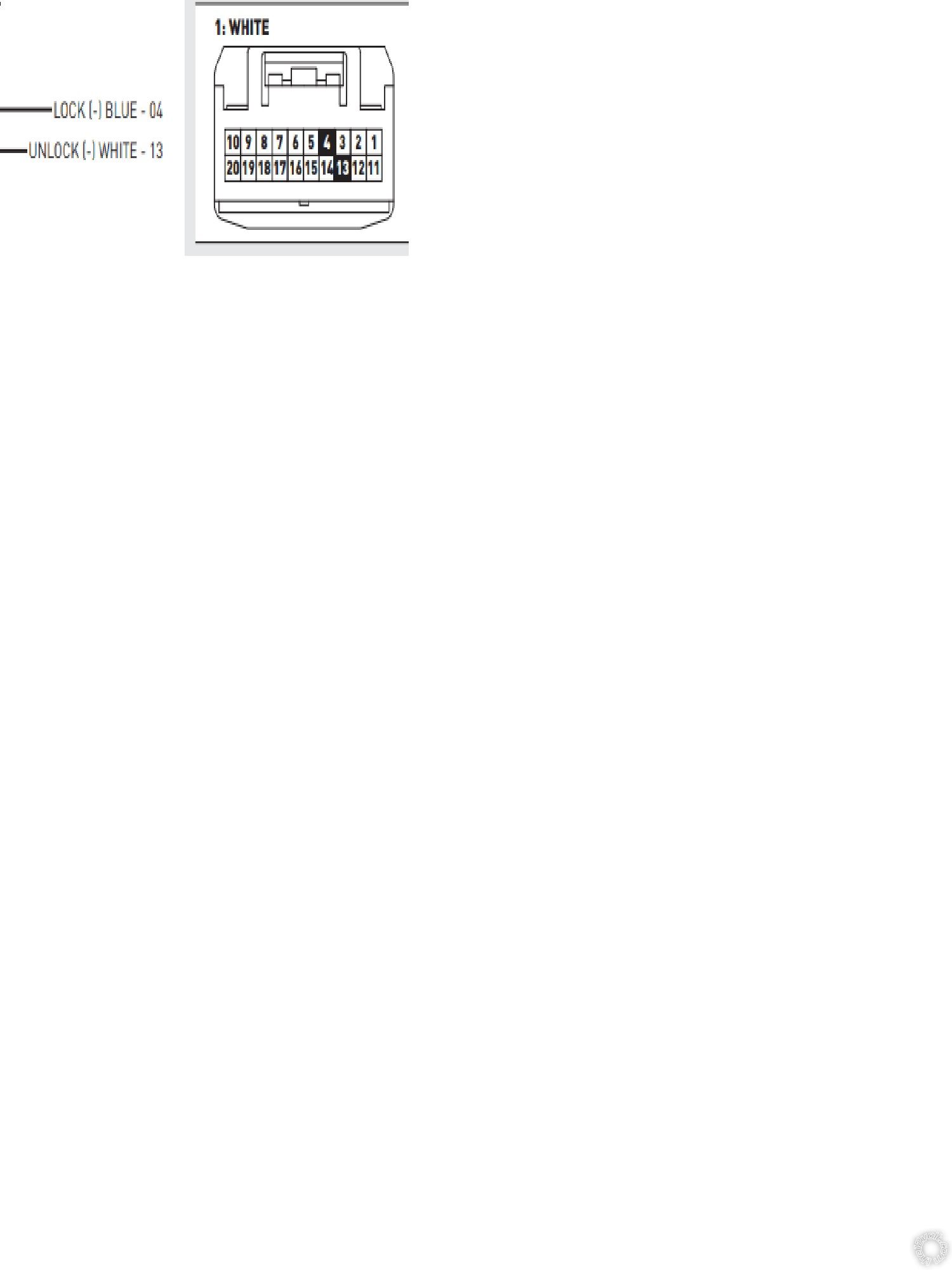

Pretty sure that the EVO-ONE does not support "3x Lock" engine remote starting on this application. You must use a aftermarket remote start FOB.
The INT-SL+ is not mandatory, just the easiest way to handle the locks from the R/S system. The Factory FOB's might still work while the engine is running under R/S going by the EVO-ONE take over procedure. Test to be sure.
ADS iDatastart handles the door locks by direct hardwire. This requires going into the driver door as shown below :
