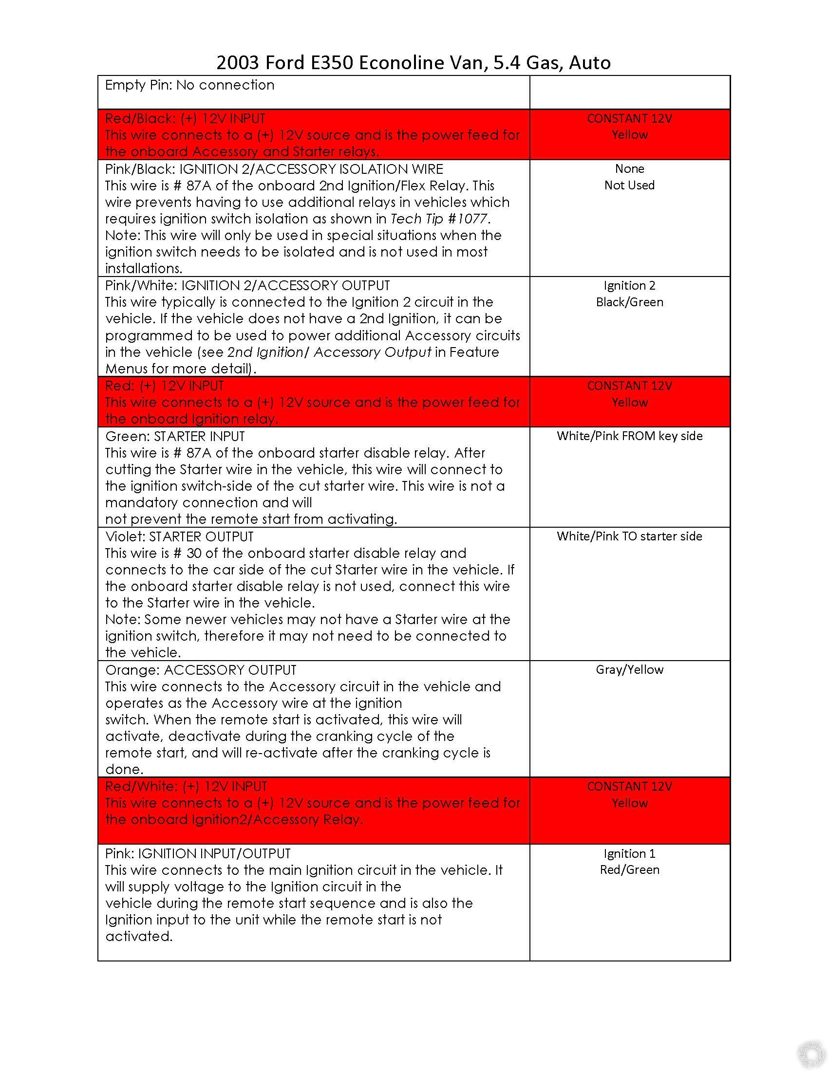

Working on a 2003 Ford E350 Econoline Van. 5.4 GAS motor.
I am not sure that I understand the wiring from the alarm/remote start.
The three "12V Input" wires are just labeled inputs. I am not sure if they mean constant inputs or ignition switched input.
I know these Vipers are pretty common so I am hoping that someone can clear it up for me.
I am attaching a pic of the plan that I have. I am just not sure on the cells that I have in red and to constant or switched.
Thanks in advance for any help!!

RED/Black, RED and RED/White all go to a constant 12 volt source.

Thank you
