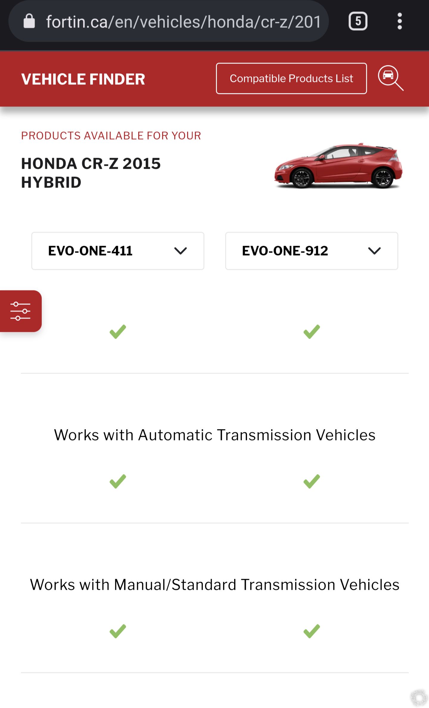

Posted: January 02, 2024 at 2:15 AM / IP Logged Link to Post Post Reply Quote assassin10000
Did some poking around on fortin's website. It does say that it's compatible with the manual trans CR-Z.
2015 Honda CR-Z Hybrid, Manual Transmission, Remote Start Wiring - Last Post -- posted image.
Why it doesn't show the clutch switch bypass wiring is concerning but nothing that can't be done with an additional relay (or two), if there is an extra (-) output that is programmable.

I got in contact with fortin and it will work like I thought it would. They just don't provide the plugs/wiring in their plug in harness or the diagrams for the layman.
