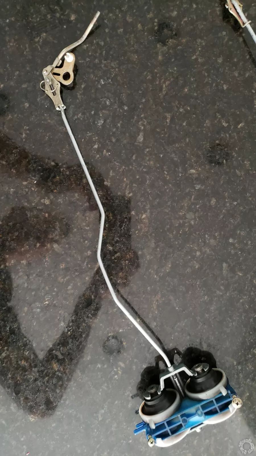

The MB W123 car's central locking mechanism rod has a very strong spring responsible for preventing the door lock rod from moving down after unlocking. See this video W123 Rod Spring.

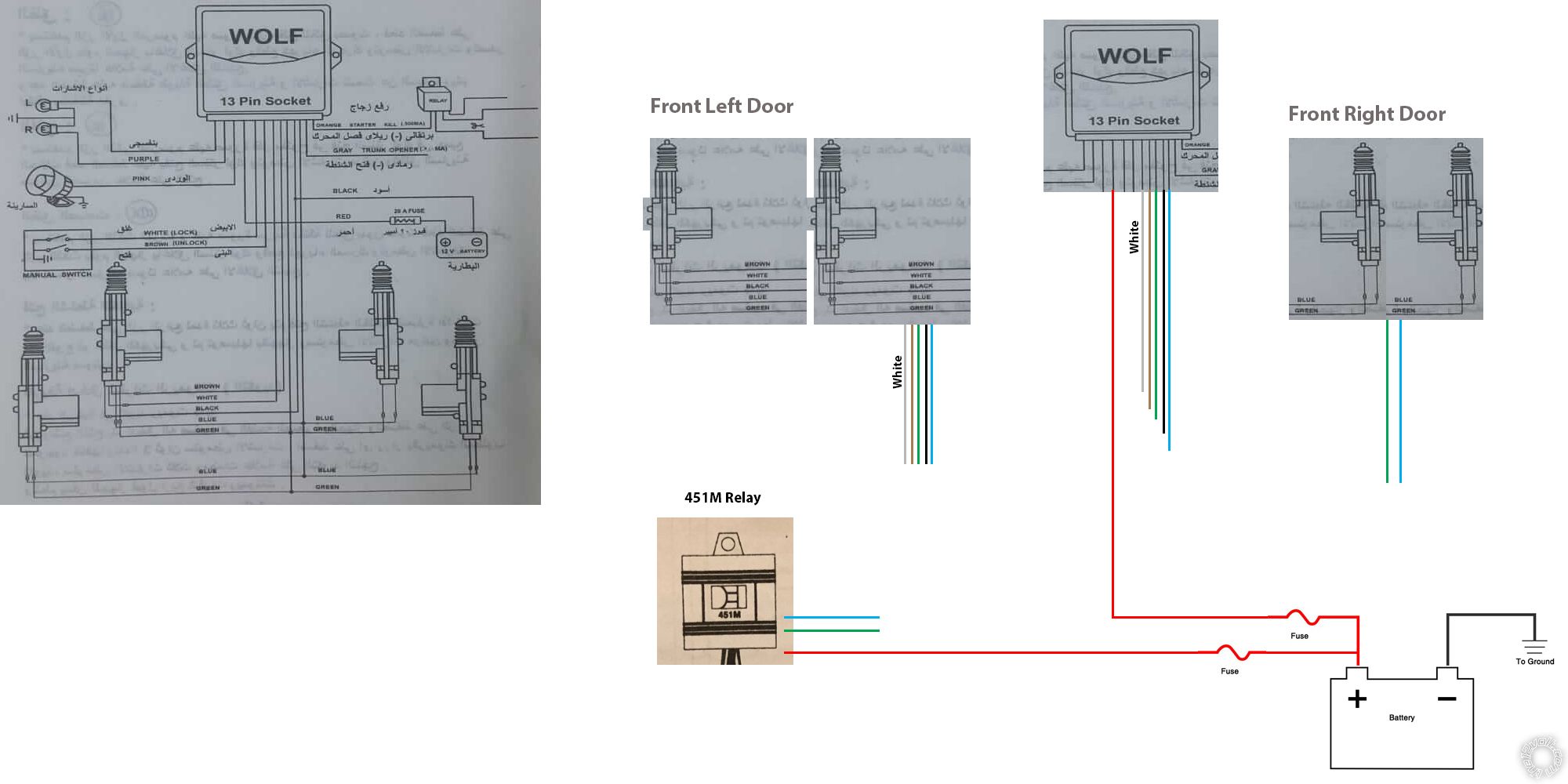

Now, I’ve decided to get the locking mechanism rods for my front doors. However, I need to know if I should use a 451M relay for this installation .
Since the rod spring is very strong, as shown in the video, I’m considering getting two actuators for each door (two 5-wire actuators for the main door) and installing the 451M relay to protect the central locking system. Does this sound like a good plan?
Now, I don't know how to wire it correctly, Since the main door has 5 wires actuator, I made a diagram in photoshop and need your help how to wiring.

The W123 original actuator and central lock rod (I don't have the original actuators)
