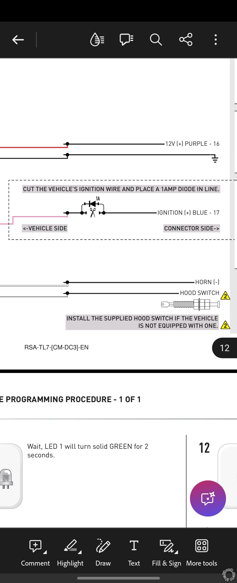

Hello, my first time doing a compustar dc3 remote start and want to make sure I do this right to achieve takeover on my 2022 prius prime. The wiring diagram below calls out for an in line 1 amp diode after cutting the blue ignition wire. My question is do I need to use two diodes? One for going from the pink ignition wire from module to the blue connector wire. Number 2 diode going from the existing blue wire we cut on vehicle side going back to the blue wire connector side. See attached image.
2022 Toyota Prius Prime, Compustar DC3 With Takeover - Last Post -- posted image.

Oh wait! I think I had this upside down. The cathode side goes towards the pink ignition wire(from module) and blue wire(i just cut) on the vehicle side right? That makes a lot more sense to me.
