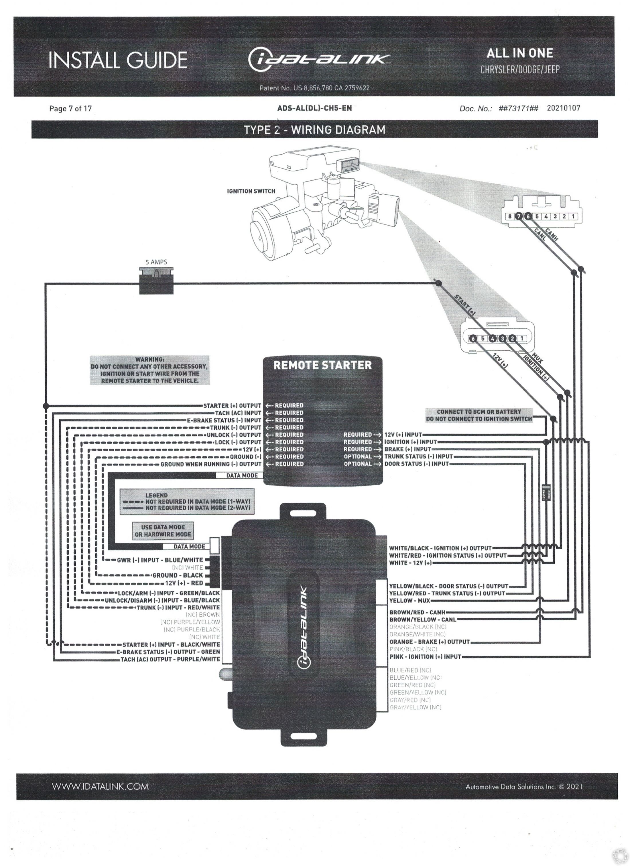

Hello, Im trying to install a Viper 4115V remote starter with an iDatalink ADS-ALCA into a 2006 Dodge Ram 3500 5.7 Hemi. I wired everything up according to the wiring diagram for the ADS-ALCA. When i remote start it, the ignition comes on and all i get is a buzzing sound coming from the TIPM, which im assuming is the starter relay. Also, whats weird is if i install the diode in the ignition wire like they want, i dont get any ignition power. If i leave the diode out, i get ignition power.

This is the wiring diagram i used. I am using 2 way data mode.
