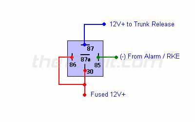

i found out that my trunk needs a positive pulse to trigger it to open.  my alarm sends a negative output pulse when u press the trunk button on the transmitter.  is this why my transmitter wont open my trunk?

you need a relay to output the large amount of current to the trunk pop.
relay wire:
alarm(-) to 85
constant power to 86&30
the trunk 87

Yes, use a relay to send a swictched postive to the trunk release
Wiring as follows
- output from alarm to pin 85 on relay
+ 12V fused to pin 86 and 30 on relay
+ 12V for trunk release to pin 87 on relay
just make sure that the fuse is big enough, most likley 10amp will do.

negative output...positive trunk? - Last Post -- posted image.

thanx guys, that worked perfectly!!!!!!!!!!!!
