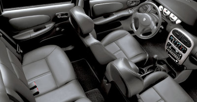

Thanks, but I checked carstereohelp.com already. the dash looks like this:
2000 Dodge Neon head unit Install - Last Post -- posted image.
Anyone done one of these cars yet?

Most neons are "Lego cars" and they have snap together panels. I can't remember for sure but there may be two screws up above and behind the vents on top. Stick a flashlight down there and have a good look around. I don't think that the neon has these screws but it better to check first. Have a look behind the ash tray as well, some cars have a couple of screws that hang out there. If no screws are present a gentle but quick snapping motion will usually dislodge the panel from the dash. Pull the panel directly towards the back of the vehicle, not forward, up or down.

if i remeber right the neon is like my festiva,    the front face for all the controls should pop off, then there should be screws or a pin romoval behind that

you pop out the vents above the radio and remove 1 phillips screw in each vent,   pull the knob off the HVAC controls and pop the dash panel off,    four phillips screws hold the radio in

Am man...thanx. I figured is was those 2 screws but I didn't know the right way to get the vents out. so how do you pop the vents out? I was gonna try that at first but I didn't want to break anything in this guys car. But he's bringing it back to me this weekend so I'm to be able to get them out.

The vents should pop out if you apply gentle pressure on them to the side. Use a pry tool and push the vents to either side by prying in the center between the vent and the center divider, use only gentle pressure and use something that will not scratch the dash. Seems I remembered correct about those screws.
