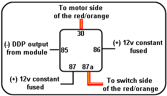

The wire for the driver door motor is RED / orange in the driver kick. Wire it up like so:
2004 F150 Driver Door Priority - Last Post -- posted image.
Be sure to test everything. Offhand the motor side should be the side going towards the driver door and the switch side will be going towards the rear of the vehicle. Good luck,

Posted: February 19, 2004 at 12:02 AM / IP Logged
That worked.  Thanks for the help!!
