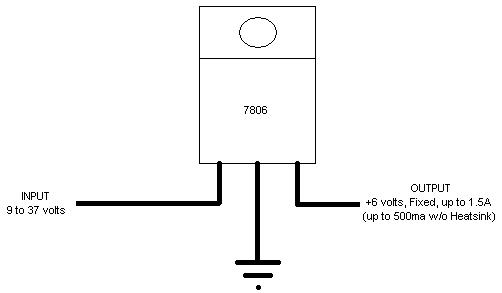

Yes, the regulator is the easiest way to do it. If you buy a three terminal fixed regulator, the most common being a 78xx with the xx being the desired fixed output voltage (and that's an industry standard number to cross reference) your installation is as simple and straight-forward as you can get. See the diagram below:
12v converted to 6volts. how to do? - Last Post -- posted image.
You can order this device pretty much any place they sell electronics components - should run about 4 dollars. The best part of this type of installation, is you need to do NO figuring, no math, no construction... it is a simple point to point device, with regulation. This means that whether you car is running or off (14.4/2 = 7.7 volts or a 28.3% OVERVOLTAGE if you use a simple voltage divider - BAAAAAD) and no matter what the load is (up to the safe operating load of the device) you will ALWAYS get just exactly 6 volts...
I would have thought a BS in Electronics would have known about simple three terminal fixed regulators... (jab - poke - jab) 12v converted to 6volts. how to do? - Last Post -- posted image.
