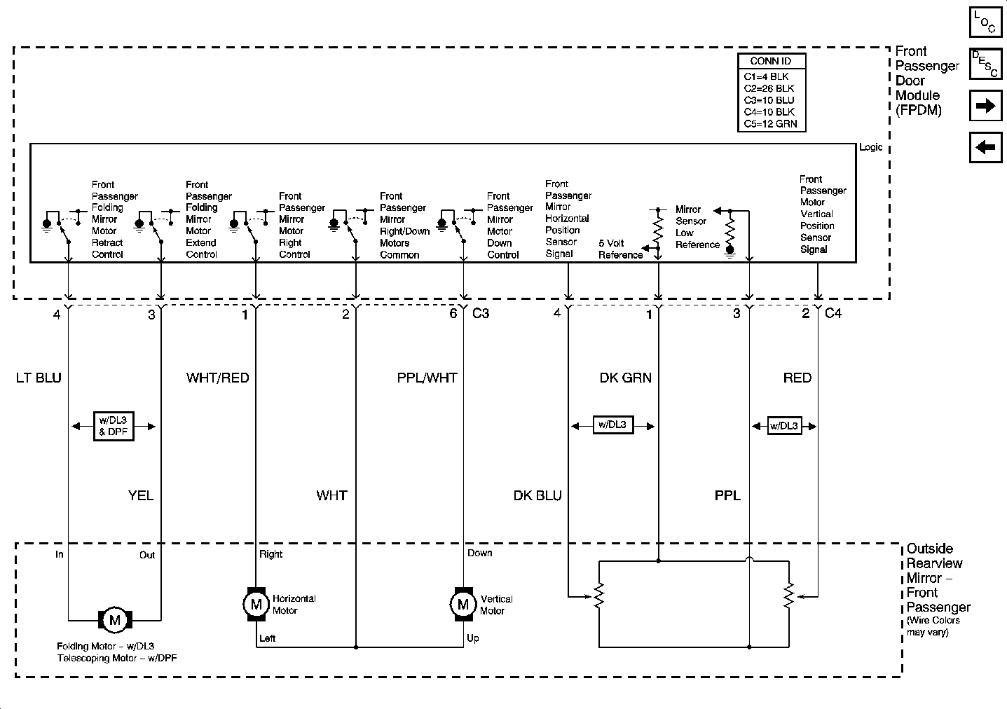

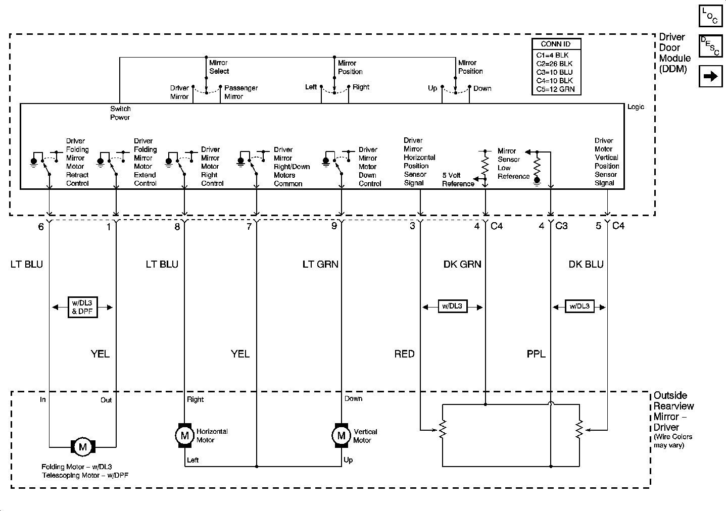

i just replaced my stock mirrors with m3 mirrors that are power and have led blinkers in them... i need the wire diagram for the switch in the truck with colors and what the wire funtion do... for example if i hit the down button to adjst mirrors what do the the wires read? thats alot any help would be great....

2003 silverado power mirrors - Last Post -- posted image.
Driver Door Module (DDM) - C3 - (Except Base)
Connector Part Information
6383393-7
10-Way F 0.64mm Unsealed AMP (BLU)
Pin
Wire Color
Circuit No.
Function
1
BRN/WHT
Left Turn Signal Low Reference
2
GRY/BLK
Left Turn Signal Control
3
BLK
Driver Mirror Heating Element Low Reference
4
PPL
Mirror Sensor Low Reference
5
Not Used
6
ORN/BLK
Left Door Exterior Courtesy Lamp Supply Voltage
7
GRY
Automatic Day/Night Mirror Signal
8
PNK
Automatic Day/Night Mirror Low Reference
9
BLK
Left Door Exterior Courtesy Lamp Ground
10
Not Used
Driver Door Module (DDM) - C4 - (Except Base)
6383393-5
10-Way F 0.64mm Unsealed AMP (BLK)
Pin
Wire Color
Circuit No.
Function
1
YEL
Driver Folding Mirror Motor Extend Control
2
ORN
Mirror Heating Element Supply Voltage
3
RED
Driver Mirror Horizontal Position Sensor Signal
4
DK GRN
5 Volt Reference
5
DK BLU
Driver Mirror Vertical Position Sensor Signal
6
LT BLU
Driver Folding Mirror Motor Retract Control
7
YEL
Driver Mirror Right/Down Motors Common
8
LT BLU
Driver Mirror Motor Right Control
9
GRN
Driver Mirror Motor Down Control
10
Not Used
Front Passenger Door Module (FPDM) - C3 - (Except Base)
6383393-7
Pin
Wire Color
Circuit No.
Function
1
RED / WHT
Front Passenger Mirror Motor Right Control
2
WHT
Front Passenger Mirror Right/Down Motors Common
3
YEL
Front Passenger Folding Mirror Motor Extend Control
4
LT BLU
Front Passenger Folding Mirror Motor Retract Control
5
ORN/BLK
Right Door Exterior Courtesy Lamp Supply Voltage
6
PPL/WHT
Front Passenger Mirror Motor Down Control
7
ORN
8
BLK
Front Passenger Heating Element Low Reference
9
BLK
Right Door Exterior Courtesy Lamp Ground
10
GRY/BLK
Right Turn Signal Control
Front Passenger Door Module (FPDM) - C4 - (Except Base)
6383393-5
Pin
Wire Color
Circuit No.
Function
1
DK GRN
5 Volt Reference
2
RED
Front Passenger Mirror Vertical Position Sensor Signal
3
PPL
4
DK BLU
Front Passenger Mirror Horizontal Position Sensor Signal
5
BRN/WHT
Right Turn Signal Low Reference
6-10
Not Used
