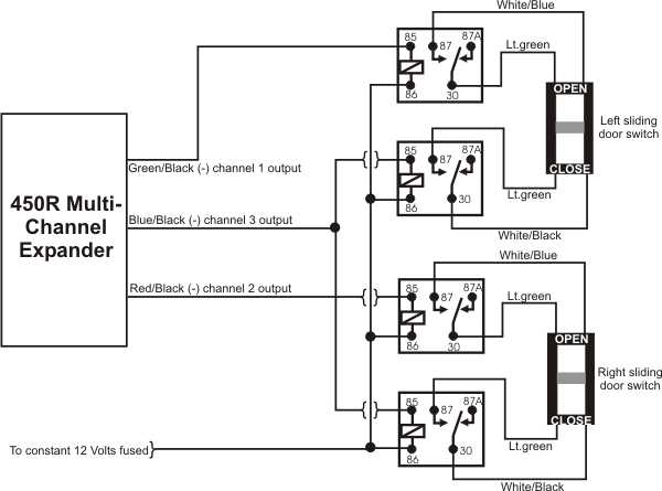

i am waiting for the notes on the sliding doors
techker
techker
Copper - Posts: 70
Joined: April 24, 2002
Posted: March 15, 2005 at 7:21 AM / IP Logged
here it is
In a Honda Odyssey 1999 and up you will need to use a 450R channel expander to operate both sliding door. The 450R will bring you the extra channels required to operate left and/or right door for both condition open and close.
99 honda odyssey power sliding door - Last Post -- posted image.
