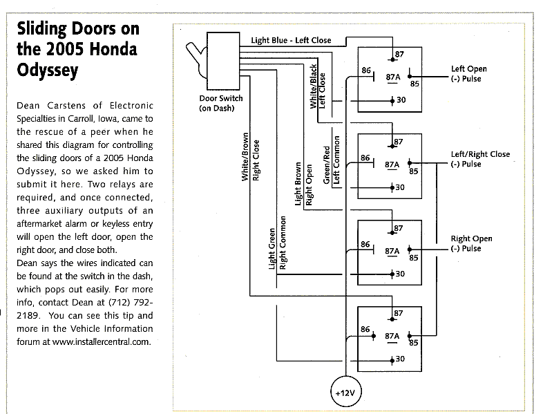

installing a viper 791 on this vehicle, i am aware that you can use the remote to slide the doors on the vehicle can anyone please help me out on how to have the doors functioning the same with the viper alarm
if anyone have any info for ex: like wire diagrams on this vehicle and also any diagrams on how to wire up the doors to slide with the viper alarm i will appreciate that thanks again for your time fellas

If youo have access to Mobile Electronics magazine the March 05 issue has the diagram on page 85.
It requires 4 relays the wires are easily located at the switch on the dash.
If i get a chance i will try to scan it and post it for you.

Here is the diagram. I hope, never posted a pic before.
