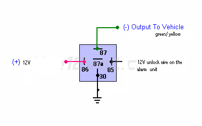

Program the alarm unit to a double pulse first as advice by mo12v. Below is the wire diagram for a stronger ground connection. I think it is a double pulse related issue rather than a ground issue.
97 Nissan Maxima Door unlock - Last Post -- posted image.
Be careful whose advice you buy, but be patient with those who supply it.97 Nissan Maxima Door unlock - Last Post -- posted image.
