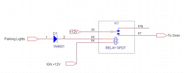

This is what you could do.
Remote start + siren - Page 2 - Last Post -- posted image.
If you want to leave your lights on with the engine off, then you should put in a switch to manually disconnect it, to prevent the siren from sounding off when you do that.

where does 87 a lead out to. just no where? other than that it makes sense, just tap the parking light wire and put i diode inbetween? just wondering why need the diode?
dualsport
Silver - Posts: 983
Joined: September 27, 2005
Posted: November 17, 2005 at 8:36 AM / IP Logged
You don't need to connect the 87A terminal; the single pole double throw (SPDT) type of relay just happens to be the most common one used around here, so I used that.
You can use a SPST relay if you have one, which doesn't have a normally closed contact.
The diode is so that the relay won't go off when you turn your ignition on and the lights off. If you didn't use the diode, your siren would go off while you were driving unless you turned the lights on.
Any time the relay control inputs (85 and 86) get a difference of 12V, it'll energize and close the relay; it doesn't matter which one is 12V and which one is ground. The diode just keeps it from energizing when the tables are turned, when there's 12V on the ignition and 0V on the parking lights.
