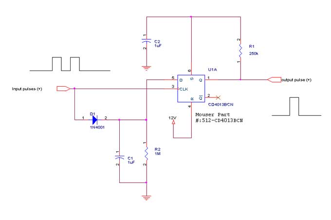

Certainly use the 3rd channel control if it has it, but just for the heck of it, you could try this-
If it gets two consecutive pulses within a second or so, it should put out a momentary pulse to do whatever you want-
If only one pulse comes in, it should ignore it and not put out anything. Might need to tweak the values of the caps and resistors to change the timing to suit.
The CD4013BCN chip is about 50 cents or so-
trunk release without button - Last Post -- posted image.
dualsport
Silver - Posts: 983
Joined: September 27, 2005
Posted: December 16, 2005 at 11:40 AM / IP Logged

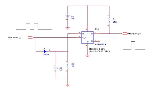

Oops, that definitely won't work with the reset pin tied to 12V- should have been connected to ground-

If the keyless has dome light survailance, you can use a relay to flip the unlock wire with that output. First push of unlock will do unlock and flip relay, second push will pop trunk....
Mike M2
Tech Manager
CS Dealer Services
dualsport
Silver - Posts: 983
Posted: December 16, 2005 at 7:09 PM / IP Logged
That's a good idea- could use any output that's active when in either an unlocked or locked condition as a control.
Then if the doors are already unlocked, pressing the unlock will pop the trunk. Then there's no timing to be concerned with.
Just have to see if he's got any type of output like that, like a ground while armed kind of signal.
