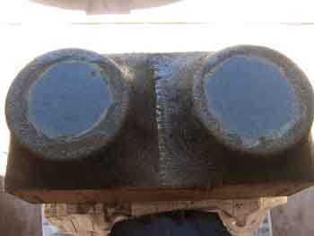

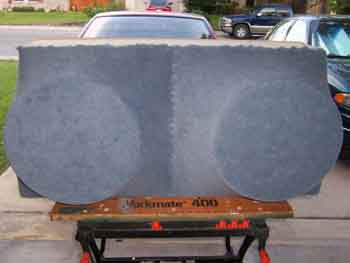

i've just finished my 1st project but i used a 1/4" thick polyester carpet w/o backing instead of fleece and this stuff streches pretty easily. it also saoks up resin like a friggin sponge; one layer and i killed a half gallon of resin!
first FG project - Last Post -- posted image.
