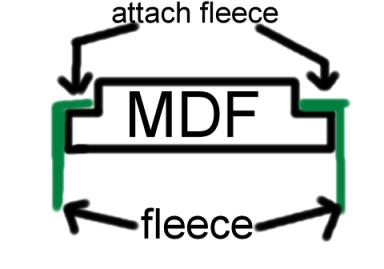

Please excuse the crude Paint image! This is a rough idea of what I am talking about. The MDF would be sitting on a flat surface. The uneven ledges where the FG and the MDF "meet" would cause a gap between the MDF and the surface it sat on. How does one get away from that?

like Imonroejr said, use a router bit to rabbit (or whatever its called) the edges, its a 90deg indent on the edge so u can attach the fleece and then blend it in.

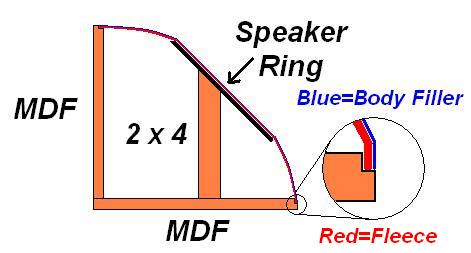

Placid Warrior has the idea...I learned it a little differently from Glassmans DVD's. You route out the top edge, so that the fleece can be stapled right into the groove. You will then have a little space above the fleece to add body filler and make the whole fleece & mdf flush. I hope this pic helps illustrate my point.
