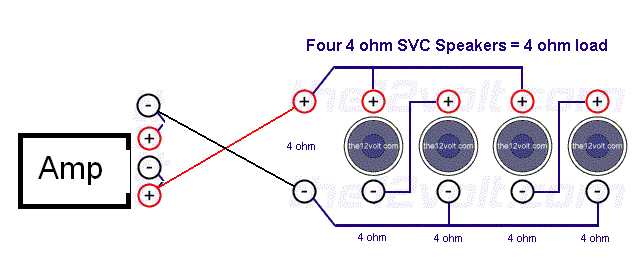

I have 4 8" 600 watt max 300 watt RMS single voice coil 4ohms each. My amp is 2000 watt max 2 channel, but can be bridged to 1. What would be the recommended wiring diagram? Would the image below work?
2 ch 2000 watt amp 4 subwoofers - Last Post -- posted image.

Yes, you have the correct wiring method.
