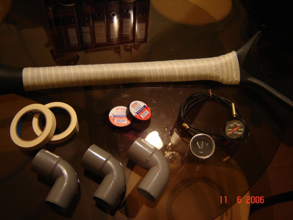

first i take out the a-pillar from my car, and cover ir with masking tape.

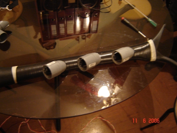

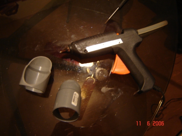

here you can see some of the materials i use.
Fiberglass Pillar Gauge Pod Step By Step - Last Post -- posted image.

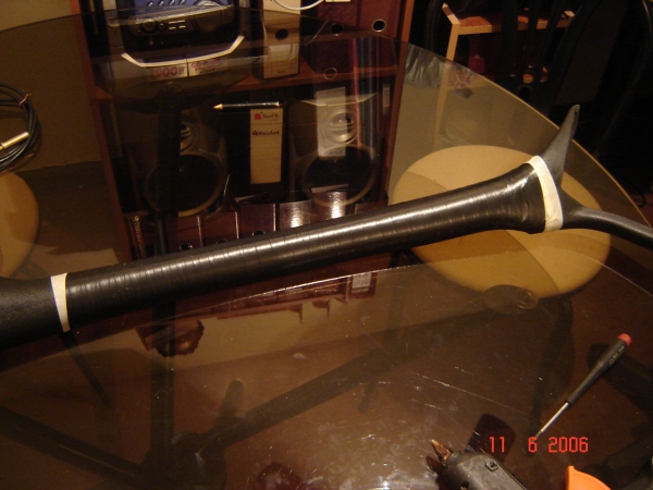

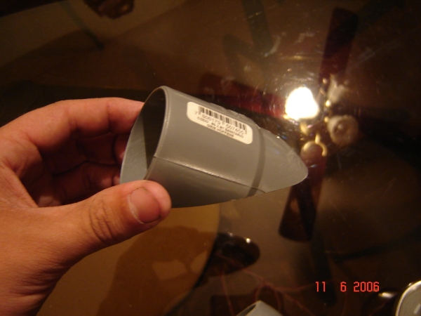

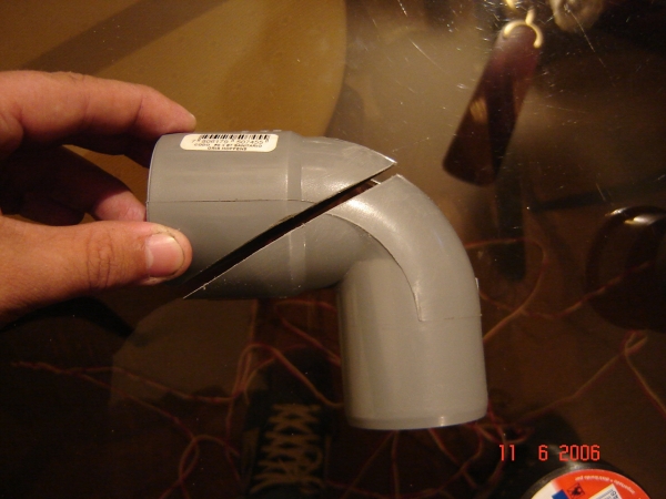

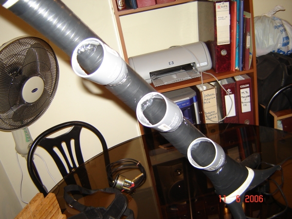

then i put electrical duct tape, cause masking tape gets impregnated with resin, and it will get stick on my pillar.

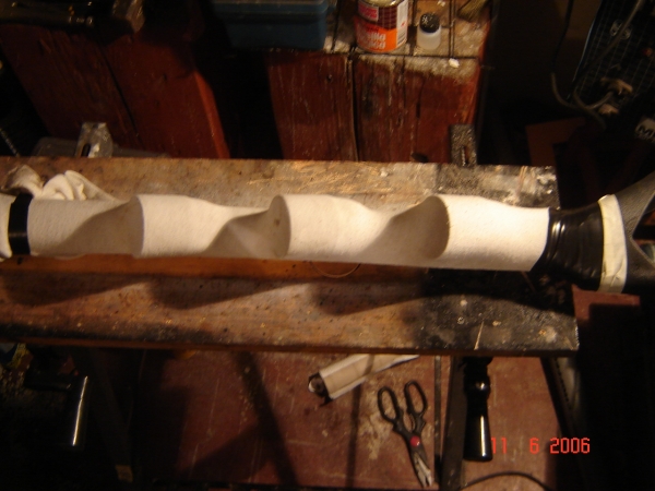

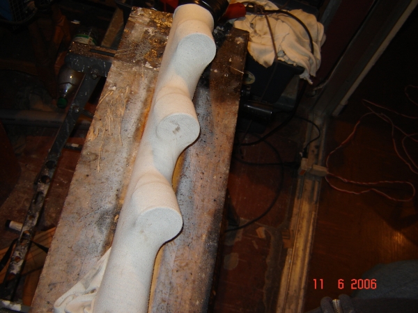

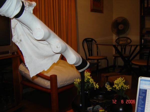

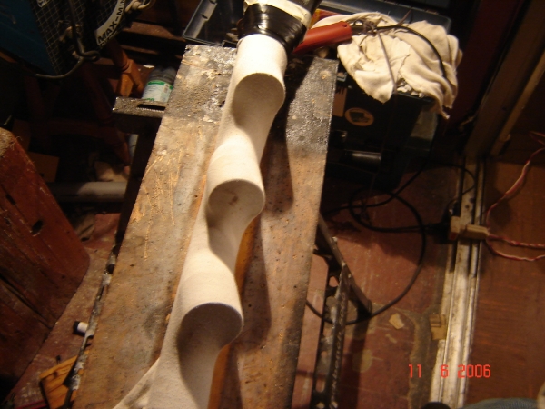

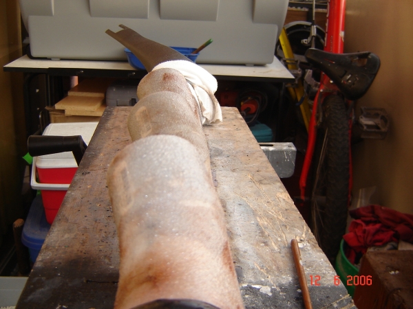

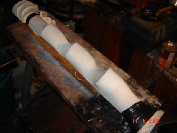

i use an old t-shirt for the next step.

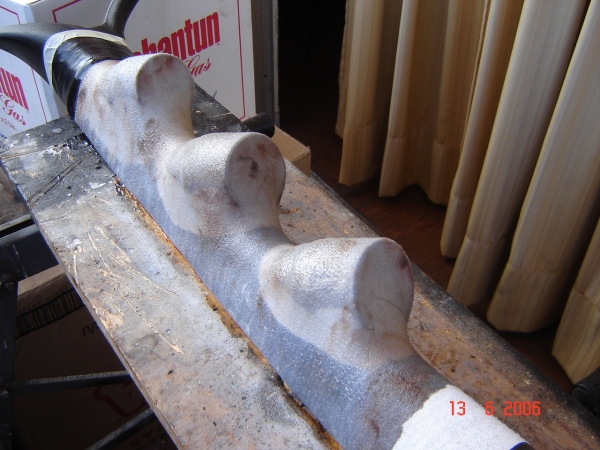

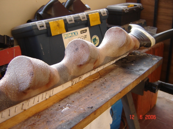

now comes the glassing.

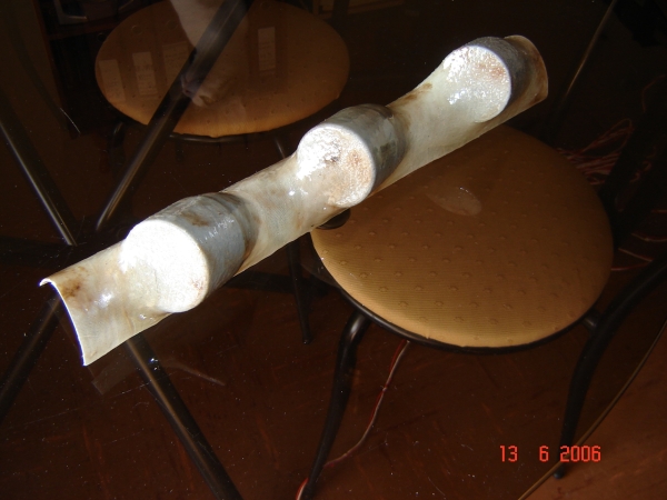

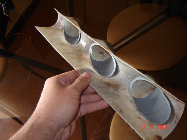

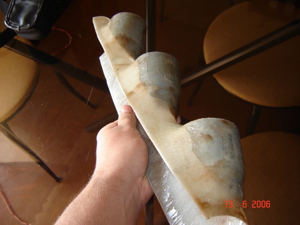

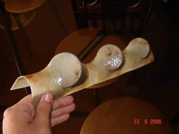

and here is the pod, dismounted from the pillar, and trimmed.

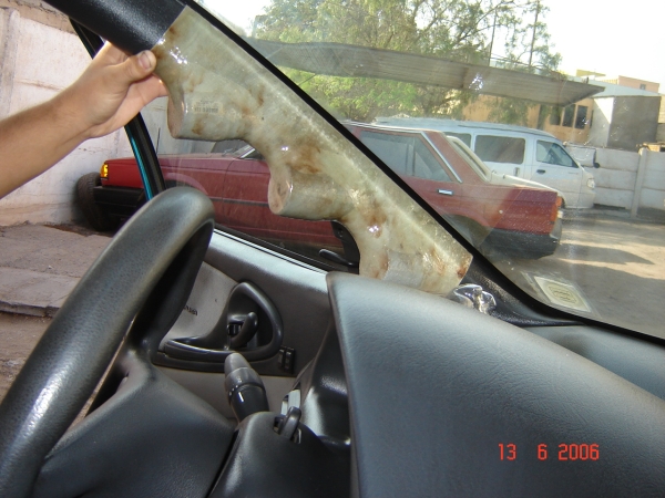

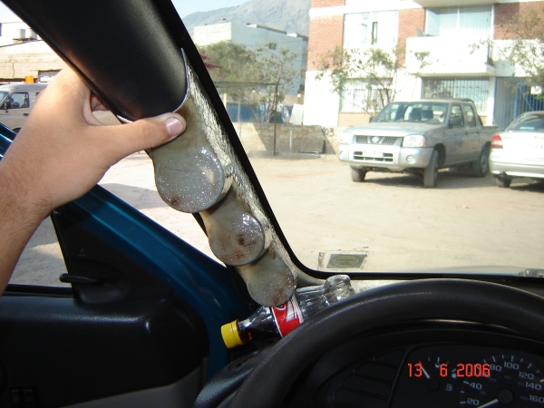

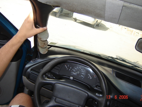

and this is how it fits in teh car, it fit perfectly, and the angle of each pod is perfect.

Do you take the Pve out or no ?
Thats a good Idea I never thought of pvc

nop, the pvc stayīs there, because it get sticked with the resin.
i dont want to try so hard to take it out because the pod is still fragil and it could break.

Looks great, but I am willing to bet that the third (lowest guage) is going to give you problems once you cut out the holes for the guage to go into. I don't think that you stretched the fleece tight enough over that one and maybe the upper most guage pod. Just my opinion but let me know how it turns out.
yeah you're right that one has problem cause the gauge will not fit wellagainst the plane face, but im planing to make another gauge pod, this time i will strech the fleece well, and will use another kind of fleece, thanks any way men.
