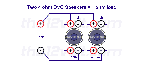

i have 2 soundstream 15"(pcw-15) an a directed 600d i want to put an one ohm load on the amp but i don't know how to wire the amp.

If they are dual 4 ohm coils and you want a 1 ohm load than parallel all the positives together and all the negatives together.
like this
