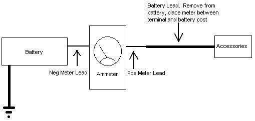

o and i do have an amp meter. how would i use it?

system draining the battery - Last Post -- posted image.
Follow that diagram, and note how much current is being pulled. Do this with the key in the off position. It shouldn't be more than maybe 100 to 150 mA, and lower than that is even better.
If it is higher than that, (it probably will be, being as you need a jump-start each morning) start pulling fuses. ONE AT A TIME. Note how much the current drops after each fuse, then replace the fuse. (I would actually start by removing the amplifier remote lead from the amp's remote terminal here, as this is the last item you installed, right?) Check for +12v on the remote terminal. If present, then there is possibly an issue with the HU or the amplifier. You did not tell us the name or brand of amp (or deck, for that matter) you have installed, but cheezy amps CAN have weird power supply issues. (I have seen them power up by themselves without a remote lead even being connected - AND not indicate being on with a power light.) If the amplifier is the offending device, pull the fuse from the deck, while having the remote lead connected. Check for +12v on the remote lead again. If it is now gone, then the HU is the offending component. Replace it.
::::::EDIT::::::
Oh, and make certain your meter is on the 20A range and jacks - FIRST. If you use the low current jacks, (probably labelled 200mA) and the current being measured exceeds what they are rated for, you can burn your meter, if it is not fuse protected.
