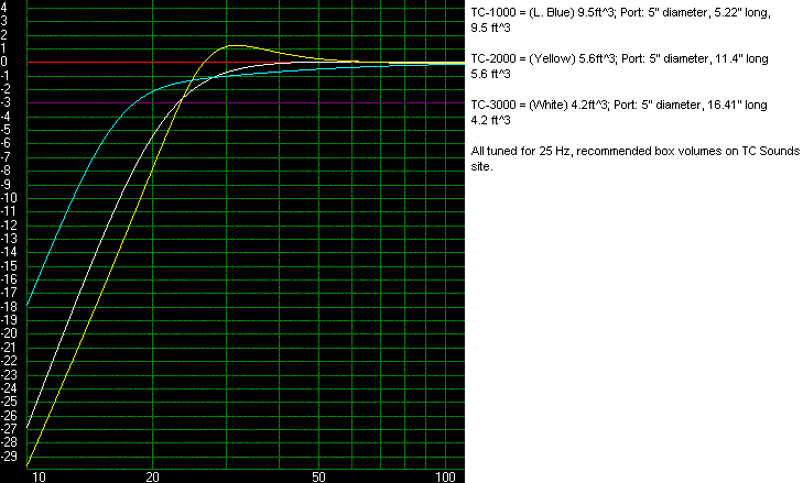

Ok Haemphyst you've convinced me to go with TC Sounds. I compared the 15" TC-1000,2000,3000 and was wondering what yall's opinion is on these. I am going for a pure SQ setup this time. What amp do you recommend for these subs?

My personal choice, based on the curves above, would be the 1000, except that's a freakin' MONSTER box!
For the smallest volume (and still a pretty sizey enclosure) the 3000 would be a good choice, but seriously, if you can afford the space, go with the 1000. A good amp choice would (or at lease COULD) be the Alpine PDX1.600 or the PDX1.1000
