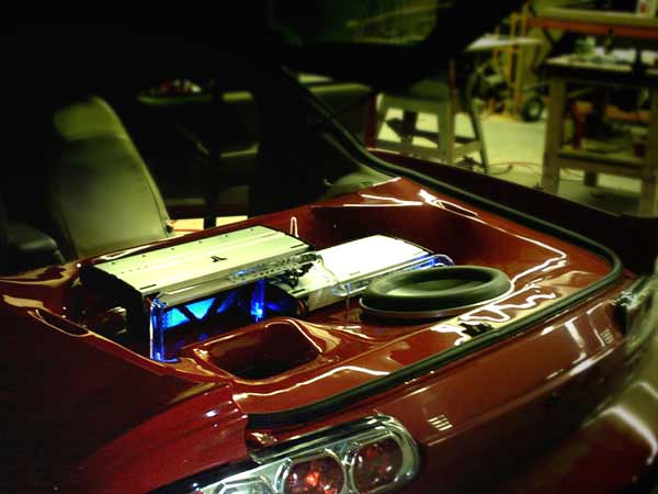

I recommend .75” with a doubled up 1.5” face. For a vented enclosure add two 1”x 2” hard wood braces from front to back and from side to side. Also take care to use thick high quality screws to mount this sub. I have seen more than one of these subs tear them selves out of an enclosure.
thickness of wood for jl audio w7 - Last Post -- posted image.
Any movement of the enclosure will negate the efforts of the sub as well as your time, your money, and your personal efforts.
