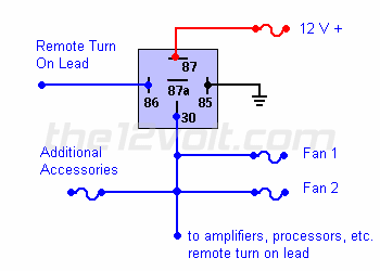

Hi Jim can i use this Config of Relay
old vw bus light problem - Last Post -- posted image.
1: Relay  86 the normal Lights for Driving Lights and the 30 the driving light
2: Relay 86 High Beam and 30 the hi Xeon light
tnx
djmaxmv
Member - Posts: 6
Joined: November 01, 2007
Posted: November 02, 2007 at 2:01 PM / IP Logged
1: Relay  86 the normal Lights for Driving Lights and the 30 the new Xeon driving light
tnx

Hi i do Dis Digram for a Relay for my Old Vw Bus whit new xeon lights
i whant to know if is ok to installed like taht Tnx all

hi all ok i this to my VW bus
install new Xeon lights
the lighst whit no relay were week
and whit a Relay were bery ok hahaha
i live pic of my work this is a temporal work until
i paint the car and finish the extra new wire but this are the new
stuf i will make to improve the Bus
the left Side is whit no Relay
the Right side is whit the relay you can see the difrences

i use this Digram one for the Driving lights and one relay for the hi beam
