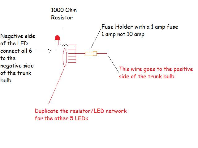

I really don't see 6 LEDs causing excessive surrent draw on a circuit that now powers an incandescent light bulb.  Attached is a diagram that will help you out.  The 1000 ohm resistor is just a safe choice, no matter what the voltage or current rating of the LEDs.  I only drew one of the 6 LEDs and resistors.  You will need to wire up 6 of these and connect each one to one of the wires on the picture.  The fuse holder and (Proper size fuse) IS neccesary.  It is not just a suggestion.  On the package of the LEDs it will tell you which leg is positive.  It does matter when connecting the LEDs.  If you have the specs of the LEDs we can get you the proper resistor value.  led's in trunk? -- posted image.

The fuse holder needs to be connected AT the light bulb.  You do not want 3 feet of wire before the fuse holder.  The less wire between the bulb and the fuse holder, the better.
