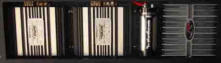

if you really want to play with bridging amps...
inverted subs in slot ported - Page 2 -- posted image.
There's about 1320watts there. Each kenwood is a 4-channel amp and the Rockford is a mono. One Kenwood powers the front components as a 2-channel bridged stereo amp, the other powers the rear components as a 2-channel bridged stereo amp, and the Rockford powers the (2) 2ohm DVC's as a mono amp.
