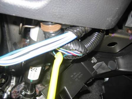

Sounds good I will give that a try. But does anybody know how to test the key sense wire? The wire in my truck is GREEN/ blk as well as my starter. I know from past experience that most of these wires are very small 22gauge or something. There is another GREEN/ blk coming out of the steering column 2nd harness Hear is a picture of it. I think this is it but I have no idea how to test it. 08 tacoma 2ign 2 start how w viper 5701 - Page 2 -- posted image.

Ok I figured the key sense out...   Ok hear is my new problem. I have installed my system and it remotely starts fine but when it’s remotely started The AC does not work. Also when remotely started the tire inflation, rear wheel diff light and the ABS light all come on. I metered the ignition harness wires again just to double check the system the and the second ignition is not energized when it is remotely started. But is energized when started normally.   Also when the system is remotely started, when I put the key in the ignition and turn it to start it shuts the car down. When I turn it to IGN/ON it operates normally, Minus the AC and the other light.   Any info would be great.
