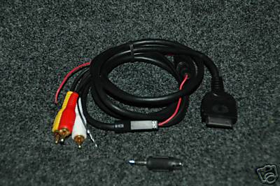

I'm getting ready to start a ground up install and was wondering if anyone had done a system without a head unit. My plan is to use an iPod as the main audio source with a PS2 for video, gaming, and if on a rare occasion I only have a track on CD. I'm using an external EQ with multiple inputs, so I'm wondering if I can just run the sources into the EQ then out to the amps. Is there some other function of the head unit that I'm missing? I'm looking at using an iPod adapter like this one: iPod Adapter

joezero
Member - Posts: 13
Joined: January 27, 2004
Posted: September 05, 2008 at 8:40 PM / IP Logged
system without head unit? -- posted image.
reax222
Copper - Posts: 220
Joined: March 11, 2006
Posted: September 05, 2008 at 9:21 PM / IP Logged
That will probably be a champ. Plug that into the eq along with your PS2, you will probably want to use the accessory wire under the column and add a switch for your remote turn on. Then the rest will be a normal install.
