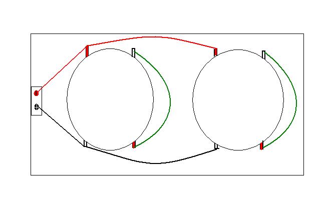

Kicker CVR12, Dual Voice Coil Wiring? -- posted image.this is how i have them wired in the box.
making (two) cvr12's 2ohm dvc into a 2ohm load combined.
shouldnt my amp be powering them enough?
ive heard these same subs hit hard with a 1000w 2ch amp.
my amp is a 1600w mono class D.
but for some reason it is not loud at all.
should i buy better wires to wire the subs??
(or does this not make a big difference?
and what is the problem that keeps shutting off my subs when i turn it up loud? or turn up the gain and lpf

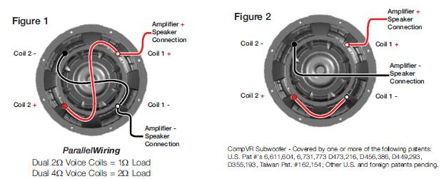

here is a copy of the manual that came with my subs.
how should i wire them to my amp?
most subs ive worked with have the voice coils side by side right
next to eachother.
these cvr's have one in each 4 corners of the sub.
and the wiring diagram above has the wires crossing the sub. usually they arent like that....

Uh huh.  No, the wire gauge is not your problem.  Either your amp is defective, or a speaker is defective, or you do not have them wired correctly (and your diagram is fine for a 2-ohms load) or you shorted out the speaker wire, or you have crap power in the car, or your amp is not really stable at 2-ohms, or your gain is too high.  Like I said before, please read and follow the "how to set your gains" sticky because based on what you've posted in this thread, you do NOT know how to "tune" your amp and this is what you should do first.

First: if you feel there isn't enough output, make certain your woofers are in phase with one another. If they are out of phase, you will get very little or no output. This is where I would start. Checking the phase is easy. Remove the leads from the amp, and "pop" the woofers with a battery. The woofers both need to move the same direction, and pretty close to the same distance...
Second: an attitude like you are coming here with will get you NO help, in a HUGE hurry. DYohn IS trying to help you... You seem to be very willing to not listen to the advice he is giving you.
ALL woofers are dynamic impedance devices, and one woofer from one manufacturer will NOT behave the same way as another woofer from EVEN IF THE NOMINAL SPECIFIED IMPEDANCE IS THE SAME. You must re-adjust your gains whenever you change a load. You cannot avoid this.
