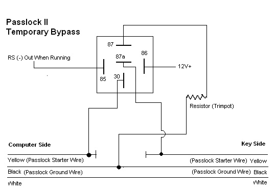

I decided to go with the relay and resistor bypass as I don't have any more money for a module. I found this diagram somewhere (not sure where, all credit to the original author).
rs 1000 in 2001 chevrolet silverado -- posted image.

I did some more research and reading around and got mostly cleared up on this one I think. The bypass and ignition wires are actually separate.
Wire on Remote start | Wire in truck
Violet | Yellow (+)
Red     | Red (+)
Red     | Red (+)
Yellow | Pink (+)
Pink    | White (+)
Brown   | Orange (+)
H10: Yellow            | Pin 85 on bypass relay
I still have a few questions:
1. Does anyone care to confirm the above information?
2. What would be a good place for a +12v source for pin 86 on the bypass relay? Would one of the red ignition wires work?
3. I have a 30/40A 12V relay that came with the remote starter. Will that work as the bypass relay?
4. Should I diode isolate any of the wires in the bypass circuit or even any of the connections made to the ignition wires?
Thanks and sorry about all the questions but I'm new.

1. the info is true, but......Always test yor wires using a DMM
2.the red wires are fine to use for this, thats what i would use. i also fuse mine. you might also do this. its a good idea.
3.that relay is just what you need.
4.you dont need to diode isolate any of those wires.

So you would just hook pin 86 up to either (not both) of the red wires?
What size fuse would be good for this?
Both wires have a fuse holder and 20 amp fuse before the enter the remote unit's brain. I'm assuming you mean yet another fuse holder and fuse, that is in the wire going to pin 86.

yes, another fuse for the wire going to term 86 on the relay. either wire is fine. and use no larger than an 10a fuse
