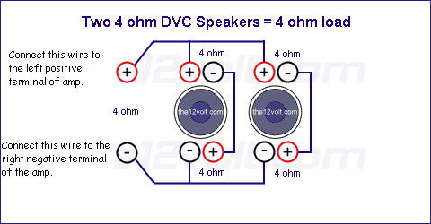

I have recently bought 2 lanzar vibe series vw12d dual voice coil speakers 1600watts a piece i am putting them in a bandpass box in a jeep cherrokee i also bought a power acoustik 2600watt gothic series amp to go with them. I need help in wiring the speakers. series or parallel or a combination of both i am looking for the deepest bass that i can get with this combo. and still be safe without frying my amp or blowing my speakers any help would be greatly appreciated & pics would`nt hurt..lol...thanx!

Dual 2 ohm, dual 4 ohm, or dual 8 ohm?   What is the minimum operating impedance your amp?

the speakers are 4ohm and the amp is 2ohm stable hope this helps

Try this one
wiring subs -- posted image.
Connect the positive wire to the left positive terminal of the amplifier. Connect the negative wire to the right negative terminal of the amp.

my speaker box only has one hookup for the speakers!
Notice there are 2 speakers in the picture, and only 1 set of connections.
