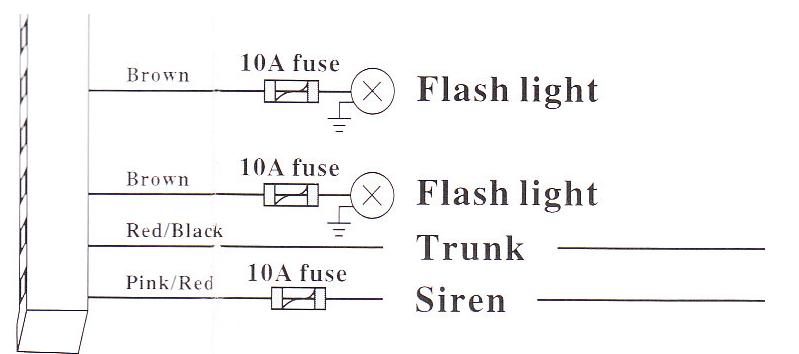

can somebody tell me what to do with the two brown wires? i'm not clear, see attachment. thx.

hook to parking lights or to indicators
