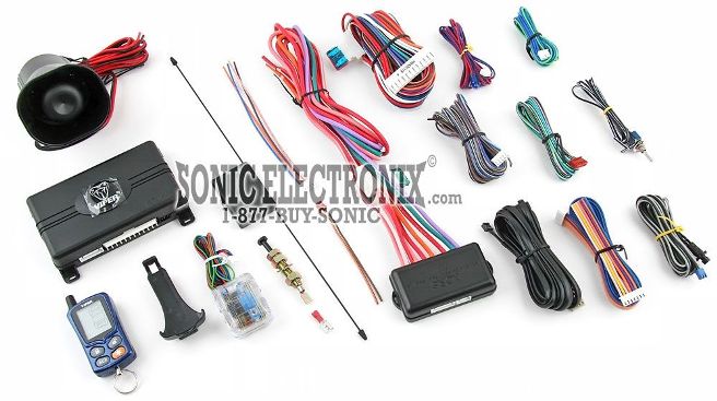

Well I bought a Viper 791xv locally off of Craigslist and I am missing 5 items.. I am installing it on a 2003 Hyundai Tiburon GT 6 Speed and I am getting it installed professionally. I am getting Alarm and Key Less Entry installed, I am not doing the Remote Start. I can describe which wires I am missing below:
missing few harnesses from viper 791xv -- posted image.
1. The Blue LED Light Wire
2. The Shut Off Switch Wire
3. The Red plug Harness Next to the Shut off switch Wire.
4. The Skinny set of wires next to the Antenna
5. The Hood Pin
What I am really concerned about as to the system actually working is number 3 and 4, as I have a factory Hood Pin allready and the blue LED wire is not required nor is the Shut off Switch wire.. Although I will be getting those installed as well, Right now I want to get just the Alarm and Key Less ready to go! If anyone knows weather or not I would NEED those wires or not please let me know! Thanks in Advance!

the wire next to the antenna wire would be the shock sensor cable, you would'nt really need this per say, it's not crictical in the functionality of the alarm, but you would not have any impact protection that's all, the harness next to your cut off switch controls factory alarm disarm/rearm, second unlock, and wait to start input and other auxillary channels 4 and 5, if you require any of these functions you will need that cable. the switch,any on/off switch would work just as well.

Sorry I don't know If i Made it clear enough.. I meant the Wire next to the Antenna it self.. not next to the antenna wire. and for the factory arm/disarm wire.. would that allow my car to atleast lock,unlock remotely and arm and disarm my new alarm? If not where would I be able to get this cable it self.. it is the 6 pin H2 Harness. so would I need the switch off cable or the Blue LED cable or can I get those installed later when I order those cables?? Also, can I use my factory hood switch/pin?

yes that's the same cable we're talking about the h2 six pin harness, you don't need the switch for the remote start, the installer could just ground the neutral switch wire, unless your transmission is manual, the led is also not mandatory for system operation, you would just be without visual detterent, i don't know if your specific vehicle has a factory alarm, maybe someone else can chime in there, if not, then that h2 harness won't be necessary,

i forgot to mention in my earlier post, yes you can use your factory pinswitch, and also i won't be able to tell you where you can get the h2 six pin harness, as you notice where i'm from, but if you're having it professionally installed, ask the installer if he has one lying around somewhere, i'm sure he just might, depending on how regularly he deals in dei, if not maybe you have a best buy or circuit city close by, or a reputable electronics store.
