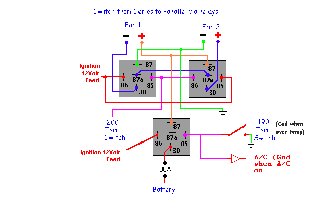

a/c as in air conditioning. and yes when ever the a?c is on then the fans will be on in slow speed. if it makes the engine get hot then the temp switch will turn them on in high speed. will this do it?
dual electric fan - Page 4 -- posted image.

I'll assume you don't want to have to turn the A/C on in order for the fans to run, and that your A/C control line is ground switched.
With those assumptions, you can just wire it like this-
Turning on the A/C will turn the fans on in low serial connected mode, and also turns them on low when the lower 190 degree switch closes.
If the high temp switch closes, the fans will be connected in full power parallel mode.
With the ignition off, the fans will remain off regardless of the thermo switch states.

I think the A/C compressor wire will be a positive wire. I have not went back to see what kind of car we are dealing with, but if the compressor has a switched positive wire, let me know.
dualsport
Silver - Posts: 983
Joined: September 27, 2005
Posted: June 20, 2009 at 6:49 AM / IP Logged
Yeah, I'm not sure what he was planning on picking up for the A/C control input, but since his/her diagram indicates it's a ground switched control, I went with that.
Either the compressor control or the main A/C switch could be used,  Advantages and drawbacks to either method I guess.  If the compressor control is used, the fans will be switching on and off continuously as it cycles the compressor. Normally that'd be harder on the relays with all the extra switching, but since it's the low power mode it might not be so bad.
Maybe he/she was planniing on using the control switch for the A/C itself, with a ground-when-on output. Either way, that's what I had to assume was being used for the control, since his/her diagram wouldn't have worked if it was high switched.

My suggestion for the A/C would be to have the fans on HIGH whenever there's a call for A/C. Engine heat isn't the reason for fans ON with A/C ON.. it's A/C high side pressure. Some of the newer cars sense this to determine when to turn the fans on during A/C operation. Lack of airflow across the condensor on a hot day with the A/C on will spike pressures and unpleasant $BIGNUM damage may result.
