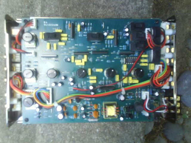

I finally got back to this thing, the sub amp is actually 16-MCA300 - Memphis 150 x 2 ClassAB So I found that noise filters were put in shortly after a new Pioneer deck.. Hmmm    The new deck was a product upgrade so he re-used the old lead adapter, which only connected Pwr, Gnd, Rem,and Mem. Gender directed him to connect RCA's connectors directly to the outputs of X/O. (Question1)Bad Idea, No?. Well coincidentally the left sub chan on the X/O blew at some point not helping the bridged Mclass-10D2/Series. I removed the X/O, and filters and the Engine noise is fierce and will require future investigation.(Or he can re-filter as he pleases) (Question2) If anyone has followed this, is it possible the filter on the X/O output blew the channel and the sub fading was the bridged amp receiving 1 input?   More questions to follow-

memphis amp fades out -- posted image.
Hopefully an Idiot has some time for suggestions on repair.
