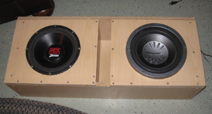

i made a dual slot ported sub box and it is suckin air and i chacked the nubs there wired right the chambers are conected the port is 2.5'' wide by 14'' high and and 7'' long with a 3'' baffle on each side
heres a pic of the encloser
sub box sucking air -- posted image.

What do you mean by "sucking air"?  If you mean port noise, that generally indicates the opening is too small.  What is your target tuning and what's the enclosure volume?
1.81 is the hole thing insted of pushing air out it is is suckig air in
thats what it looks like inside
1995 jeep wrangler 4X4

The port is sucking in and blowing out at a rate of 20 to 100 times a second.  You can not see this.
What exactly is going on that makes you think it is sucking air?
Does it suck air if only one woofer is connected?  When only one woofer is connected, does it make more bass than with the 2 of them playing?
yes it still sucks air when only one is on and has less bass with one. i made this box cuz i wannted more bass and i got more but i didnt no how to make the port so i just winged it how do i get the deepest bass

I think it is just the subs that are sucking but......

It looks like the screws on the outside face are like 2" in. Are they even hitting the side panels?
there not 2'' there 1 1/4'' and yess it only 3/4'' melamine board

Are the side panels set in to allow for that or are you screwing into nothing? You are probably  leaking air.
