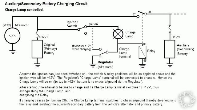

I thought the B+ had to supply the dual battery charging system in a seperate path? This seems to me to have it available to either battery that would need charged.  I'm not an engineer so I'm seeking info here.

Maybe my diagram below from my aforementioned trailor alarm wiring link explains all that is required.
Although shown as charge-light controlled Aux Relay, merely use whatever voltage sensing system output in place of the "Charge Lamp terminal".

Adding a Second Battery - Page 5 -- posted image.

If you want a guaranteed reserve battery using 2 batteries, my diagram (method) above is good.
But it is not for a longer reserve time for accessories - it provides independent reserve times.
