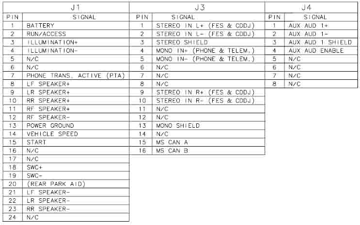

my main question is... is there a way that i can tap off the sub out put to the shaker 500 head unit to go directly to my amps? i study the wiring diagrams and it driving me nuts. thank your for your time folks.

Can you post a link or a picture of the diagram that is driving you nuts?

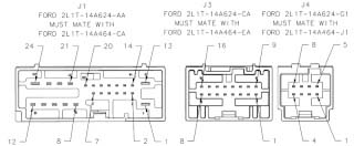

Posted: August 16, 2009 at 1:37 PM / IP Logged
i hope this comes out big enough to see it.
06 mustang gt/ a shaker 500 -- posted image.

use J4 for your sub out...pin 1 for the center, pin 2 for the shield on your rca cable.
y-adapter the output so to feed both channels of the amp equally.
you can use pin 4 for the trigger (remote in) on the amp, but you'll probably need a turn-on adapter.  DEI and PAC both have them.  you could also use J1--pin 2 but them woofer amp will remain on even with the radio turned off.
i've heard of people using (removing) the trip computer switch connector (same style as J4) to access the above wiring.  assuming the vehicle doesn't have that feature of course.

my car don't have the j4 plug coming out of the harness. just the j1 and j3. i'll try to make something up or maybe get luck at walmart with a wiring harness. i'll get something going and try it out.
