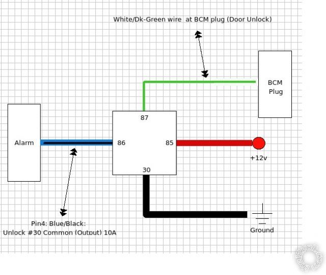

Right now, I have to blu/black wire from the alarm going directly to the WHITE/ DkGreen wire at the BCM plug.
Unless Ive made a mistake,,,here is what I believe I need to do.
disarm function not working all else ok - Page 2 -- posted image.

Posted: October 28, 2009 at 10:07 AM / IP Logged
Anyone ?
Does this look right?
thx

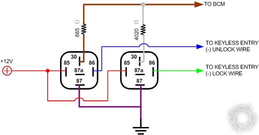

Chris suggested that you test the functions before making it permanent. Ultimately, it should look something like this:

Beautiful illustration and thank you VERY much for the assist!
