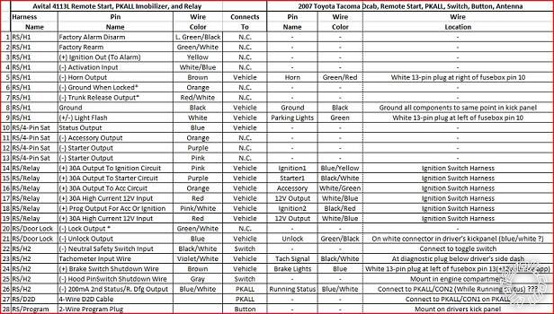

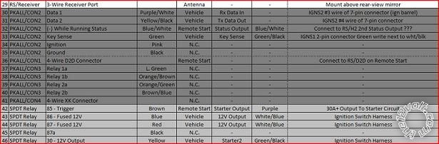

I'm installing the Avital 4113L Remote Start with the PKALL Imobilizer into a 2007 Toyota Tacoma Double Cab V6 4x4 Sport TRD. I searched the web and couldn't find an exact installation. My plan is to document this from beginning to end with pictures. This also requires a relay for the 2nd starter wire. I chose the Crime Stoppers High Current Relay XX402A ($1.99) and the Crime Stoppers Pre-wired Relay Socket ($1.99) from Sears. My Tacoma does not have a security system, so I believe this eliminates some connections. This is my first remote start, so I created a spreadsheet to keep track of all the connections. In the spreadsheet I have listed on the left hand side all of the wires from the Avital 4113L, PKALL, and the Relay that I can identify so far and on the right hand side to where these wires should be connected. I'd appreciate any input as I proceed. Thanks.
Avital 4113l, Pkall, 2007 Tacoma Double Cab V6 -- posted image.
