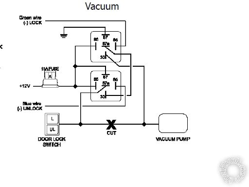

is this the correct method for wiring the "single Negative Wire" relays for my car and if it is what diode is used (or how is this determined) and how do i wire for both driver and passenger.

and also where is the diode placed between pin 85 and green wire(-)lock)on top relay and pin 85 and blue wire(-)unlock) on bottom relay or does is go between pin 87a and door lock switch on bottom relay and between pin 30 and vacuum pump on top relay. I know it needs to be diode isolated i just dont know where they need to be placed.

I would check your lock wire info, that diagramme is fine for Mercedes/Audi mid 80s on,  reversing polarity single wire control. Having looked at the 03 on the vehicle wiring section on this site, it shows neg log and unlock at the BSM so your alarm's green and blue go to those two wires with the diodes, 1N4004 in line on the green and blue with the bands towards the alarm. Suggest you look at the vehicle wiring site since you haven't mentioned the year and why should I do your work for you? You won't need the relays.

A slight apology is called for, I've just looked at the listings, 03/04/05 and they all give different lock systems!!!   Don't throw away the relays just yet, but please, obey the posting rules and tell us which year,  your vehicle is a prime reason for stating year and model!  By the way the other post should have said BCM not BSM.

Sorry, its a 2005 Saturn Ion Redline coupe. I looked at the vehicle wire diagram from this site and it states that it is a single negative white wire and to look at diagram and the diagram i posted is the one i found. Thanks for you help it is appreciated

its a 1 wire lock setup, straight ground to unlock and ground thru a 1500 ohm resistor to lock
Posted: November 14, 2009 at 4:36 PM / IP Logged
OK, I looked as well, if you mean the single white wire at the BCM this is the way to go. Green lock to relay 85. Good ground to relay 30, 12v+ constant to 86 and join 87 to single white wire. Unlock blue to second relay 85, god ground to relay 30, 12v+ constant to 86 and join 87 to the white wire at the same point but this time insert a 1.5Kohm resistor inline between 87 and the white wire.  Share the grounds and the 12volts on the relays, fuse the 12volts at 3amps. Thr reason for the relays is that the lock outputs won't give enough juice to overcome the resistance. The relays also isolate the Ion's locking system from the alarm so diodes aren't needed. This is assuming your alarm system and you STILL haven't followed the rules and told me what it is only has the two lock/unlock wires. If it has 6, you won't need the relays.

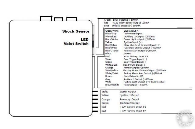

What? if your talking about what alarm hears the diagram:

Yes, Howie was talking about what kind of alarm system you were installing. If the system would of had onboard relays, the wiring would be different. Anyways, click here for diagram.
