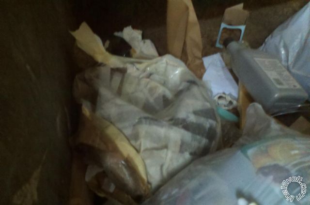

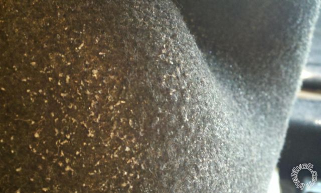

Well I have another reason why I hate winter....
winter + fiberglass = MORE MEKPmazdaspeed protege system build - Page 3 -- posted image. mazdaspeed protege system build - Page 3 -- posted image. mazdaspeed protege system build - Page 3 -- posted image.
Oh and don't use doodiey tape. And always use two layers...its not a waste.
I didn't care because I was going to put black carpeting over the sides of my trunk anyway. But if that had hardened it probably would not have come off.
