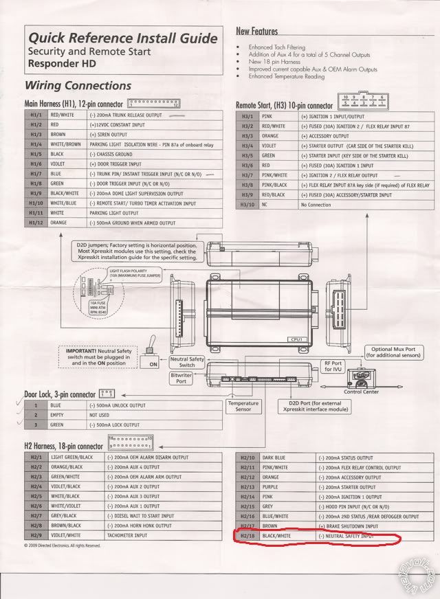

Have you gone threw the Remote starting Diagnostics section on page(57)? The Viper 5901 should come set for Manual Transmission as the default setting? Make sure your using the right (BLACK/ white) wire, neutral safety wire its on the 5 pin connector. And make sure all your door pins are connected properly for proper programming.

well i dont have the trunk pin wire hooked up. that might be the reason. also there is not a 5 pin connector on the 5901..heres a quick reference guide..
