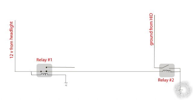

Here is my original problem. Relay #1 is a velleman MK-111, relay #2 is a radioshack 30amp 12v relay.
upon getting +12v from the headlight will relay #1 open in time to prevent momentary closure of relay #2?dei528t relay w/ hid kit - Page 3 -- posted image.

That Velleman MK-111 kit is going to continually turn your headlight on and off since it isn't a one shot circuit.
It wouldn't work as is because your headlight would be on all the time if you use the NC-COM contacts and you'd only get a short pulse if you used the NO-COM contacts.
This is all that's needed to insert a delay in the switched output.
Just change the values of the cap and resistor for whatever delay time you want. Larger cap and resistor values increase the delay time, smaller values decrease it.
