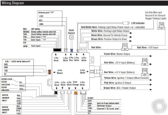

I am trying to install a marksman x7 remote start. The guy i got it from just yanked it out and doesn't have a install manual. After some comparison of other models i have part of the wiring guide. But alot to be assigned still. I have made a markup paint shop of the control box, with what i know, and opening it up and reading the,,,idk,,acronyms,, of the pins. Can someone, a few, compare the attached pdf or jpg and help me decrypt this. I have search everywhere online for a manual to no avail, so the hard way it is. Thank you in advance for your help. If i get this 100% decrypted i will surely share as i know theirs not much online about it.marksman x7 pinout -- posted image.

Looks like a knock-off 5901 from the wire colours with no starter cut, not a bad thing. At least it has a tach input.

howie ll wrote:
Looks like a knock-off 5901 from the wire colors with no starter cut, not a bad thing. At least it has a tach input.
What brand? This manufacture is same for like 5-6 different "Brand" names.
Posted: April 27, 2010 at 11:54 AM / IP Logged
All the brands are now the same except for their only decent product, G5 Clifford.
I'm afraid you're on your own with this unless someone happens to have done one and can tell you what is what. I'll try Mr. Google when I get bored but don't hold your breath. Generally these units are NOT DIY as we well know from some of the stupid questions here.
Posted: April 27, 2010 at 11:57 AM / IP Logged
There don't appear to be any door, trunk or hood trigger inputs, good luck.
Posted: April 27, 2010 at 12:29 PM / IP Logged
Try Googling Magnadyne Marksman

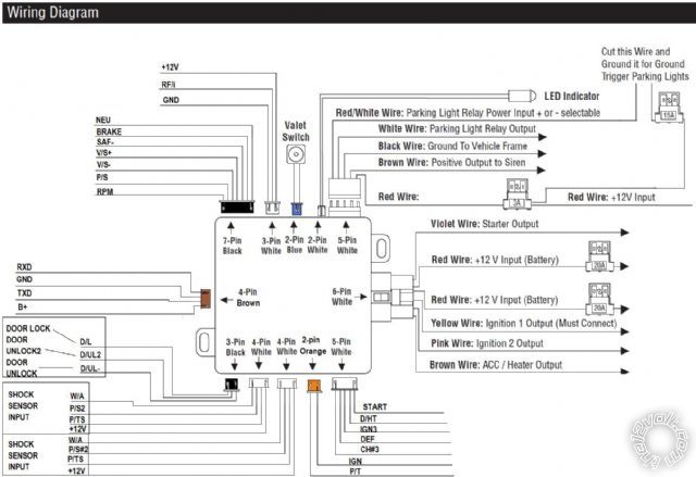

Been there. I did google it many times and places. Google, yahoo, msn, dogpile, pdf search, etc. but i do have and upate to the diagrahm for those interested.marksman x7 pinout -- posted image.
